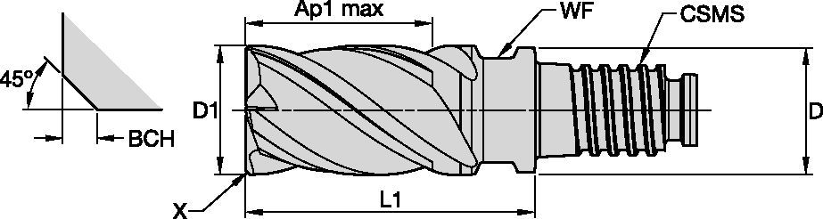

  • Tool Dimensions: Flute Configuration: 4Tool Dimensions: Flute Configuration: 4
Drawings for 6072110
Material Number6072110
ISO Catalog IDUKDV1000X4CV
ANSI Catalog IDUKDV1000X4CV
GradeKCPM15
Adapter Style Machine SideDUO-LOCK
[D1] Effective Cutting Diameter10 mm
[D1] Effective Cutting Diameter0.3937 in
[D] Adapter / Shank / Bore Diameter9.6 mm
[D] Adapter / Shank / Bore Diameter0.378 in
[AP1MAX] 1st Maximum Cutting Depth15 mm
[AP1MAX] 1st Maximum Cutting Depth0.5906 in
[L1] Gage Length22.5 mm
[L1] Gage Length0.8858 in
[CSMS] System Size Machine SideDL10
[WF] Width of Flat 8 mm
[WF] Width of Flat 0.315 in
[BCH] Corner Chamfer Width 0.5 mm
[BCH] Corner Chamfer Width 0.0197 in
[Z] Number of Flutes4
