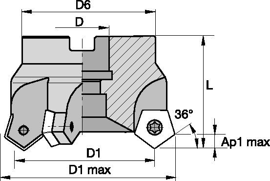

Drawings for 1888193
Material Number1888193
ISO Catalog ID125B08RS36PD12
ANSI Catalog ID125B08RS36PD12
[D1MAX] Maximum Cutting Diameter125 mm
[D1MAX] Maximum Cutting Diameter4.9213 in
[D1] Effective Cutting Diameter106.2 mm
[D1] Effective Cutting Diameter4.1811 in
[D] Adapter / Shank / Bore Diameter1.5748 in
[D6] Hub Diameter 90 mm
[D6] Hub Diameter 3.5433 in
[L] Overall Length 55 mm
[L] Overall Length 2.165 in
[AP1MAX] 1st Maximum Cutting Depth5.5 mm
[AP1MAX] 1st Maximum Cutting Depth0.2165 in
Number of Inserts8
Maximum Ramping Angle3
Weight Kilograms2.3
Gage InsertPD_X1204__SNGN

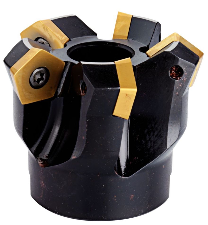

  • Use for heavy roughing operations.
  • Low cutting forces.
  • Higher feed rates.
