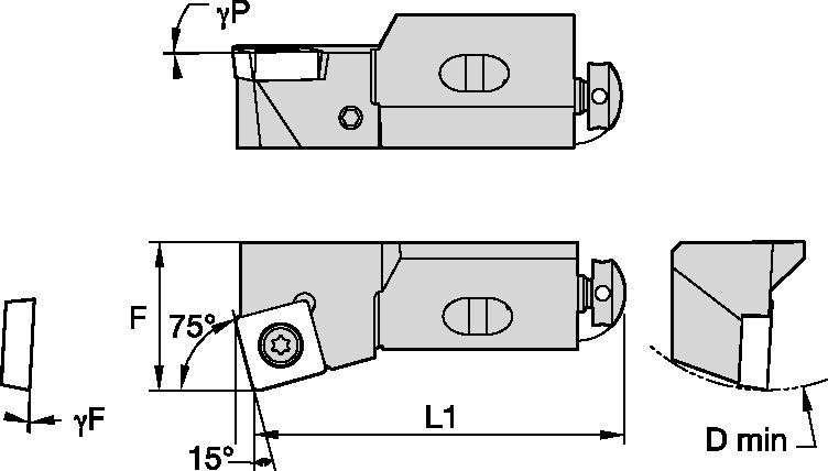

Drawings for 1098721
Material Number1098721
ISO Catalog IDSSKCL12CA12
ANSI Catalog IDSSKCL12CA12
[DM] Minimum Bore Diameter 50 mm
[DM] Minimum Bore Diameter 1.9685 in
[F] F Dimension 20 mm
[F] F Dimension 0.7874 in
[L1] Tool Length 55 mm
[L1] Tool Length 2.1654 in
[L1A] L1 A Dimension 3.06 mm
[L1A] L1 A Dimension 0.1205 in
[GAAP] Axial Rake Angle0
Gage InsertSC..120408/SC..432
