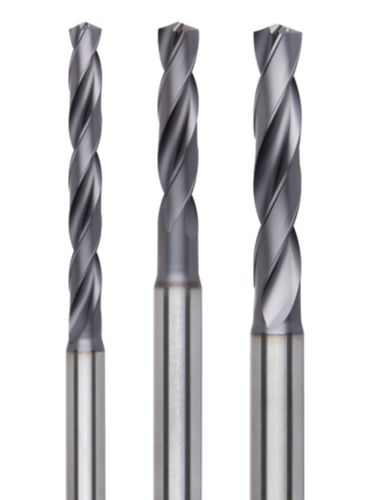

Three Kennametal Kenna Universal Drills
The universal application profile of Kenna Universal™ drills reduces tool change times and the number of drills in inventory.
