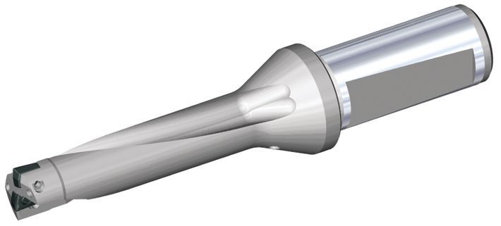

DFR Whistle Notch (WD) Shank • 4 x D
Drill Fix™ DFR™ Bodies
Material Number2457737
ISO Catalog IDDFR175R4WD32MANSI Catalog IDDFR175R4WD32M

| Material Number | 2457737 |
| ISO Catalog ID | DFR175R4WD32M |
| ANSI Catalog ID | DFR175R4WD32M |
| [D] Adapter / Shank / Bore Diameter | 32 mm |
| [D] Adapter / Shank / Bore Diameter | 1.2598 in |
| [D1] Drill Diameter M | 17.5 mm |
| [D1] Drill Diameter M | 0.689 in |
| [D1MAX] Drill Diameter Maximum | 18.5 mm |
| [D1MAX] Drill Diameter Maximum | 0.7283 in |
| [L1] Insert Gage Length | 99 mm |
| [L1] Insert Gage Length | 3.8976 in |
| [L4] Maximum Drilling Depth | 70 mm |
| [L4] Maximum Drilling Depth | 2.7559 in |
| [L5] Drill Point Length | 0.62 mm |
| [L5] Drill Point Length | 0.0244 in |
| [LS] Shank Length | 58 mm |
| [LS] Shank Length | 2.2835 in |
| Gage Insert | DFR0302. |

- Drill Fix DFR with rectangular-shaped inserts offer highest stability and feed rates at smaller sizes.
- X-offset design to adjust diameter size on turning machines and optimize tolerances on machining centers.
- Drill shipped with insert screws and Torx wrench.
