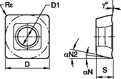

SAP Material Number 4042906
ISO Catalog Number SPPX15T512FP
ANSI Catalog Number SPPX15T512FP
Grade KCPK10
[D] Insert IC Size 15.732 mm
[D] Insert IC Size .625 in
[D1] Insert Hole Size 5.5 mm
[D1] Insert Hole Size .217 in
[S] Insert Thickness 5.95 mm
[S] Insert Thickness .234 in
[Rε] Corner Radius 1.2 mm
[Rε] Corner Radius .0469 in
[GAA] Insert Rake Angle 6
[Clearance Angle Major 7
Clearance Angle Major Second 11
