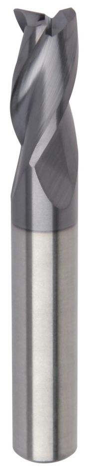

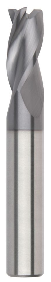

  • DIN number 6527DIN number 6527
  • Tool Dimensions: Flute Configuration: 3Tool Dimensions: Flute Configuration: 3

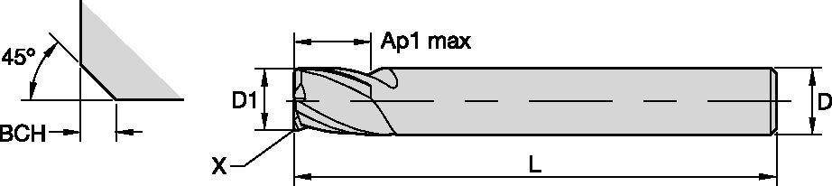

Drawings for 6146948
Material Number6146948
ISO Catalog ID3CH0600DL010A
ANSI Catalog ID3CH0600DL010A
GradeKC633M
[D1] Effective Cutting Diameter6 mm
[D1] Effective Cutting Diameter0.2362 in
[D] Adapter / Shank / Bore Diameter6 mm
[D] Adapter / Shank / Bore Diameter0.2362 in
[AP1MAX] 1st Maximum Cutting Depth10 mm
[AP1MAX] 1st Maximum Cutting Depth0.3937 in
[L] Overall Length 57 mm
[L] Overall Length 2.2441 in
[BCH] Corner Chamfer Width 0.1 mm
[BCH] Corner Chamfer Width 0.0039 in
[Z] Number of Flutes3
KC633M
KC633M
Coated carbide grade with PVD multilayer coating. KC633M™ is designed for dry milling most types of material, apart from the hardened variety. This grade is characterized by high hardness and wear resistance. It provides outstanding protection for solid carbide tools against cratering and abrasion.
