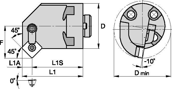

[D] Adapter / Shank / Bore Diameter63.5 mm
[D] Adapter / Shank / Bore Diameter2.5 in
[DM] Minimum Bore Diameter 82.55 mm
[DM] Minimum Bore Diameter 3.25 in
[F] F Dimension 44.45 mm
[F] F Dimension 1.75 in
[L1] Tool Length 41.275 mm
[L1] Tool Length 1.625 in
[L1A] L1 A Dimension 12.878 mm
[L1A] L1 A Dimension 0.507 in
[L1S] Secondary Tool Length 28.397 mm
[L1S] Secondary Tool Length 1.118 in
Gage InsertSN..643
Lock Pin ID Drive Size9/64
Clamp Screw ID Drive Size5/32
