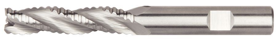

KenCut™ ALR • SFRHEC • Chamfered • 3 Flutes • Weldon® Shank • Inch
Solid Carbide End Mill for Aluminum Roughing
Material Number2658446
ISO Catalog IDSFRHEC500S3200ANSI Catalog IDSFRHEC500S3200
KenCut ALR Solid Carbide End Mill - SFRHEC - Chamfered - 3 Flutes - Weldon Shank - Inch - Grade K600 - 2658446 - Kennametal.com
$280.26/each
  • Tool Dimensions: Flute Configuration: 3Tool Dimensions: Flute Configuration: 3
Drawings for 2658446
GradeK600
Adapter Style Machine SideWeldon
[D1] Effective Cutting Diameter12.7 mm
[D1] Effective Cutting Diameter0.5 in
[D] Adapter / Shank / Bore Diameter12.7 mm
[D] Adapter / Shank / Bore Diameter0.5 in
[AP1MAX] 1st Maximum Cutting Depth50.8 mm
[AP1MAX] 1st Maximum Cutting Depth2 in
[L3] Usable Length50.8 mm
[L3] Usable Length2 in
[L] Overall Length 114.3 mm
[L] Overall Length 4.5 in
[BCH] Corner Chamfer Width 1 mm
[BCH] Corner Chamfer Width 0.0394 in
[Z] Number of Flutes3
K600
K600
Carbide grade made from high-quality, micrograin materials for cutting all types of workpiece materials. Very high toughness ensures a controlled wear rate. The micrograin structure enables extremely sharp cutting edges.
  • Solid carbide end mill with cord profile, for low cutting forces and low power consumption.
