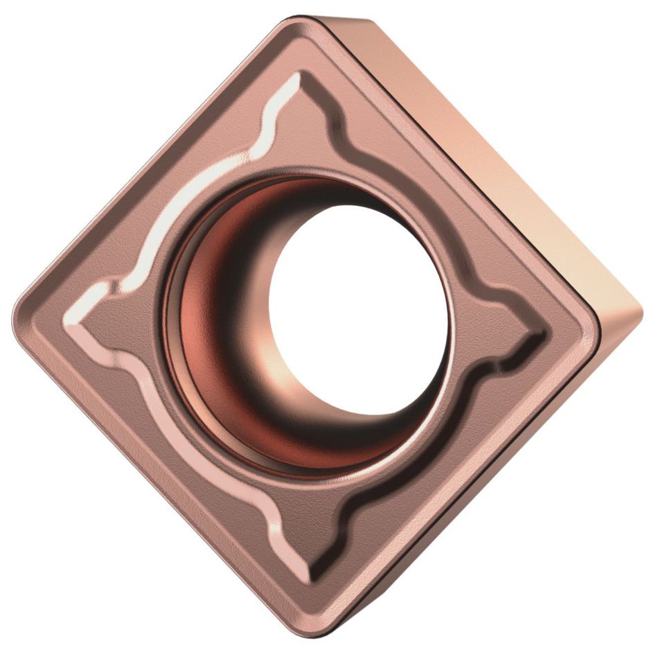

Screw-On • SCMT Insert • Positive • MF
ISO Turning Carbide Insert • Medium Finishing Geometry
Material Number5698783
ISO Catalog IDSCMT120408MFANSI Catalog IDSCMT432MF
Screw-On SCMT ISO/ANSI Turning Insert 5698783 - Kennametal
$32.69/each
Drawings for 5698783
GradeKCK15B
[D] Insert IC Size12.7 mm
[D] Insert IC Size0.5 in
[S] Insert Thickness4.76 mm
[S] Insert Thickness0.1875 in
[Rε] Corner Radius 0.8 mm
[Rε] Corner Radius 0.031 in
[D1] Insert Hole Size 5.5 mm
[D1] Insert Hole Size 0.2165 in
KCK15B
KCK15B
Composition: A multilayered coating with thick MTCVD TiCN-Al2O3-TiOCN layers applied over a carbide substrate specifically engineered for cast irons.
Application: Delivers consistent performance in high-speed machining of gray and ductile irons. The substrate design permits the insert to stay in the cut for a long time at high speeds with minimum deformation. The thick CVD coating and post-coat treatment provide superior wear resistance ensuring long and consistent tool life. Can be applied both in straight and lightly interrupted cuts.
  • Versatile geometry to be used for finishing and medium applications in multiple material groups
