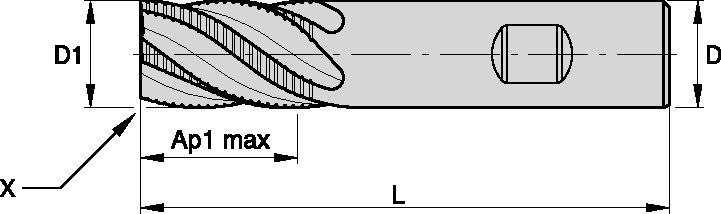

  • Helix Angle: 20°Helix Angle: 20°
Drawings for 4047075
Material Number4047075
ISO Catalog IDF4BJ1400BWL20L260
ANSI Catalog IDF4BJ1400BWL20L260
GradeKCPM15
Adapter Style Machine SideWeldon
[D1] Effective Cutting Diameter14 mm
[D1] Effective Cutting Diameter0.5512 in
[D] Adapter / Shank / Bore Diameter14 mm
[D] Adapter / Shank / Bore Diameter0.5512 in
[AP1MAX] 1st Maximum Cutting Depth26 mm
[AP1MAX] 1st Maximum Cutting Depth1.0236 in
[L] Overall Length 83 mm
[L] Overall Length 3.2677 in
[BCH] Corner Chamfer Width 0.5 mm
[BCH] Corner Chamfer Width 0.0197 in
[Z] Number of Flutes4
KCPM15
KCPM15
  • Solid carbide end mill with cord profile, for low cutting forces and low power consumption
