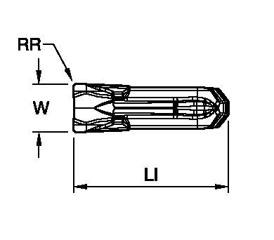

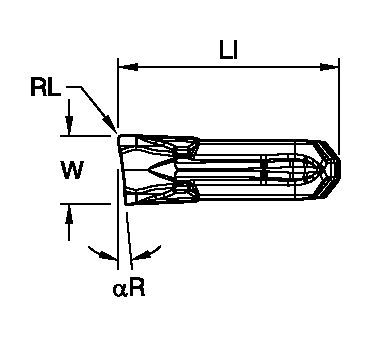

Drawings for 6017498
Material Number6017498
ISO Catalog IDEC030M03R06CF02
ANSI Catalog IDEC030M03R06CF02
GradeKCM35B
Insert Size3
[W] Cutting Width 3 mm
[W] Cutting Width 0.1181 in
Cuttg Width (+/-) Tolerance0.075 mm
Cuttg Width (+/-) Tolerance0.003 in
[LI] Insert Length 9.6 mm
[LI] Insert Length 0.378 in
Cutting Edge Angle Right Hand6
[RL] Corner Radius 0.2 mm
[RL] Corner Radius 0.008 in
