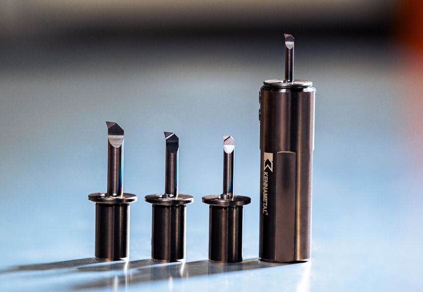

The TopSwiss MBS Medical Line (ML) inserts feature a specialized coating and sharp cutting edges for superior surface finishes and reduced tool pressure, ensuring precision and biocompatibility for medical-grade applications. They are ideal for components like bone screws, tulip heads, dental implants, and surgical instruments.
Specifically designed for machining materials such as stainless steel, titanium or cobalt chrome, the ML inserts feature the Kennametal coating KCSM25S, which provides a smooth, polished surface to reduce chip adhesion and improve component surface quality. Along with the proprietary coating, the inserts feature a unique lead and relief angle that can withstand high tool pressure and has coolant delivered directly through the tool to the cutting edge to reduce heat and improve chip control.

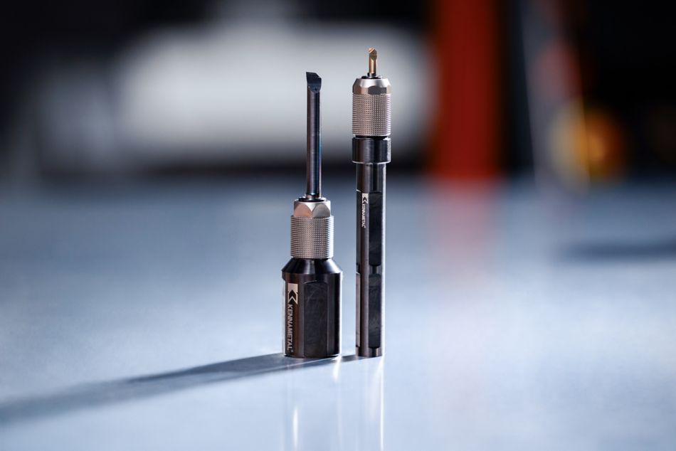

For optimal performance, pair the inserts with (HP) tool holders, which offer high precision and repeatability to centerline of ±5 microns, (±0.0002".) The HP holders are user-friendly, the uniquely designed lock nut requires only hand tightening for most applications, wrench tightening is required for applications that use high-pressure coolant of 70 Bar or 1,000 PSI and above.

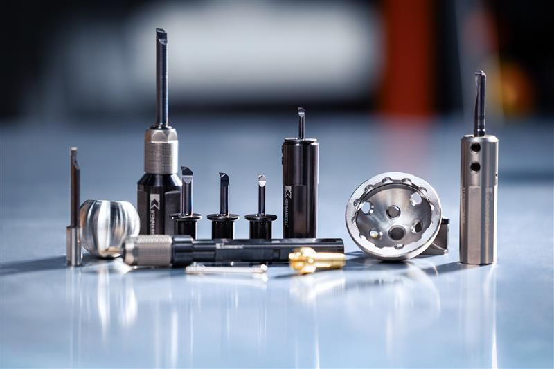

For small parts such as couplings, reducers and adapters found across many industries, the versatility of the TopSwiss MBS offering excels. With nearly 1,000 inserts, TopSwiss MBS can address a broad range of applications including boring, profiling, back boring, grooving, threading and multi-directional turning.
When paired with bushing style holders, which accept reduction bushings, just one holder has the versatility to accept any size or any style of insert, allowing the highest flexibility to CNC programming and machine setup and operation. Beyond the standard offering, TopSwiss MBS offers diverse custom solution capabilities to address the most challenging component features and requirements. This flexibility ensures that even the most complex machining tasks can be handled with precision and efficiency.
