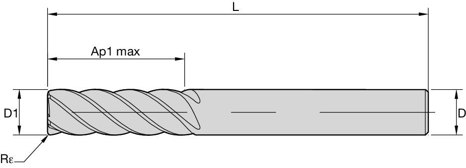

  • Tool Dimensions: Flute Configuration: 5Tool Dimensions: Flute Configuration: 5
  • Helix Angle: 40°Helix Angle: 40°
Drawings for 6558730
Material Number6558730
ISO Catalog IDTCDE0625N5CRB
ANSI Catalog IDTCDE0625N5CRB
GradeKC643M
Adapter Style Machine SideSAFE-LOCK
[Re] Corner Radius 0.75 mm
[Re] Corner Radius 0.03 in
[Z] Number of Flutes5
[D1] Effective Cutting Diameter15.875 mm
[D1] Effective Cutting Diameter0.625 in
[D] Adapter / Shank / Bore Diameter15.875 mm
[D] Adapter / Shank / Bore Diameter0.625 in
[AP1MAX] 1st Maximum Cutting Depth47.625 mm
[AP1MAX] 1st Maximum Cutting Depth1.875 in
[L] Overall Length 101.6 mm
[L] Overall Length 4 in
