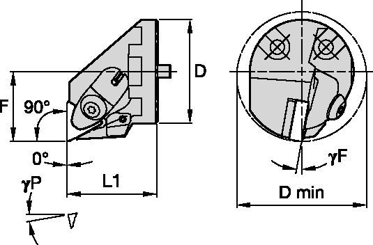

Drawings for 6549438
Material Number6549438
ISO Catalog IDH5063DTFNR22
ANSI Catalog ID,5063DTFNR22
[D] Adapter / Shank / Bore Diameter50 mm
[D] Adapter / Shank / Bore Diameter1.97 in
[DM] Minimum Bore Diameter 63 mm
[DM] Minimum Bore Diameter 2.4803 in
[F] F Dimension 35 mm
[F] F Dimension 1.378 in
[L1] Tool Length 35.638 mm
[L1] Tool Length 1.4031 in
[GAAP] Axial Rake Angle5
Gage InsertTNMA220408
