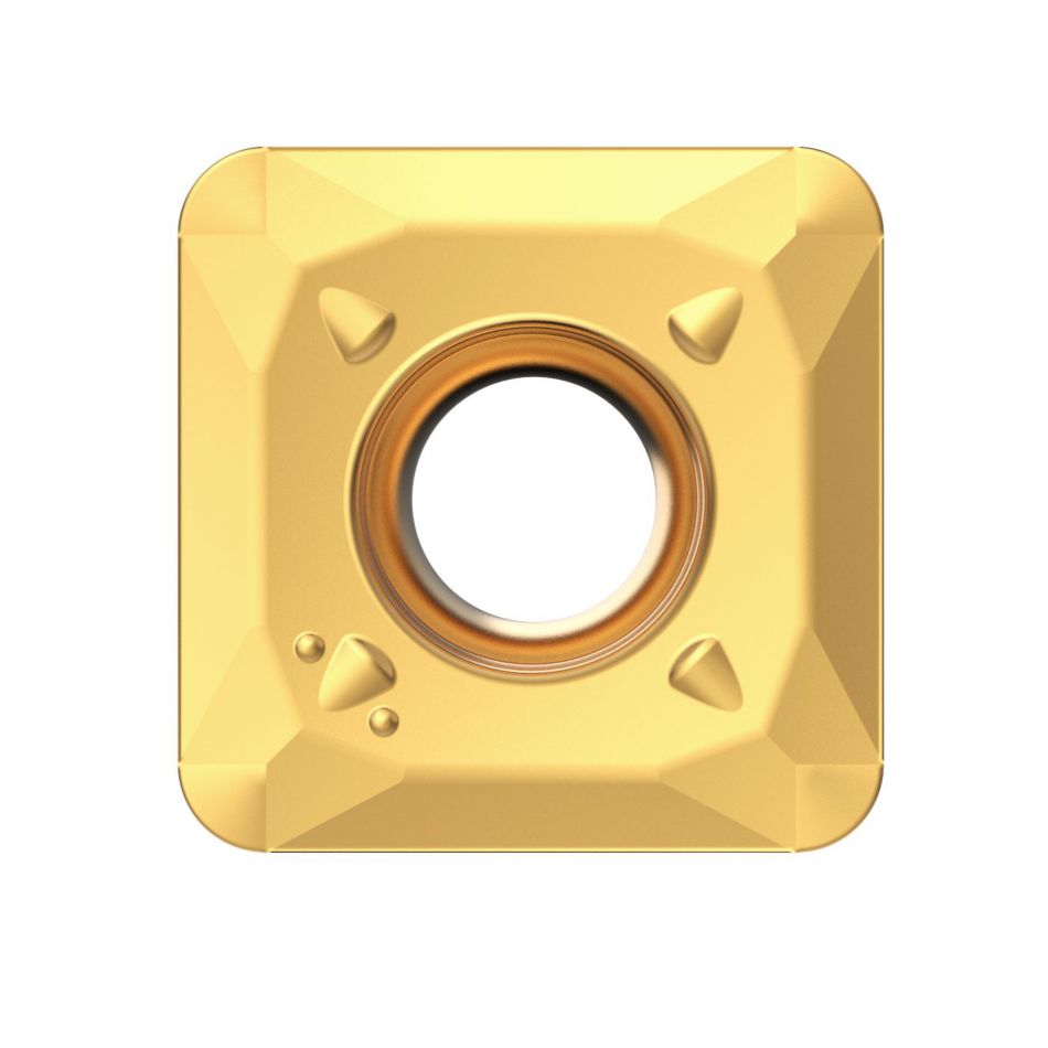

Insert Selection Guide
| KSSM™ 12 • Insert Selection Guide | ||||||
| – | (Light geometry) | – | (Strong geometry) | |||
| – | wear | toughness | ||||
| P1–P2 | .E..LD2 | KCPM40 | .E..GB2 | KCPM40 | .S..GB2 | KCPM40 |
| P3–P4 | .E..LD2 | KCPM40 | .E..GB2 | KCPK30 | .S..GB2 | KCPK30 |
| P5–P6 | .E..LD2 | KC725M | .E..GB2 | KC725M | .S..GB2 | KC725M |
| M1–M2 | .E..LD2 | KCSM40 | .E..GB2 | KCSM40 | .S..GB2 | KCSM40 |
| M3 | .E..LD2 | KCPM40 | .E..GB2 | KCPM40 | .S..GB2 | KCPM40 |
| K1–K2 | .E..LD2 | KCK20B | .E..GB2 | KCK15 | .S..GN | KY3500 |
| K3 | .E..LD2 | KCK20B | .E..GB2 | KCK20B | .S..GB2 | KCK20B |
| N1–N2 | .F..LE | KC410M | .F..LE | KC410M | .F..LE | KC410M |
| N3 | .F..LE | KC410M | .F..LE | KC410M | .F..LE | KC410M |
| S1–S2 | .E..LD2 | KC725M | .E..GB2 | KC725M | .S..GB2 | KC725M |
| S3 | .E..LD2 | KCSM40 | .E..GB2 | KCSM40 | .S..GB2 | KCSM40 |
| S4 | .E..LD2 | KCSM40 | .E..GB2 | KCSM40 | .S..GB2 | KCSM40 |
