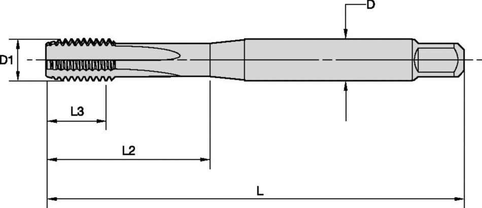

Drawings for 4156545
Material Number4156545
ISO Catalog IDT642M120X175R6HX-D6
ANSI Catalog IDT642M120X175R6HX-D6
GradeKP6525
[D1-TDZ] Thread Diameter SizeM12 X 1.75
[L] Overall Length 110 mm
[L] Overall Length 4.33 in
[L3] Thread Length 18 mm
[L3] Thread Length 0.71 in
[L2] Useable Length 44 mm
[L2] Useable Length 1.73 in
[D] Adapter / Shank / Bore Diameter9 mm
[D] Adapter / Shank / Bore Diameter0.3543 in
[Z] Number of Flutes4
Dimension StandardDIN 376
Thread Tolerance Class ISO6HX-I
