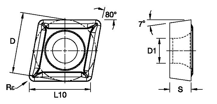

Drawings for 1162362
Material Number1162362
ISO Catalog IDCCMT120404LF
ANSI Catalog IDCCMT431LF
GradeKC850
[D] Insert IC Size12.7 mm
[D] Insert IC Size0.5 in
[L10] Insert Cutting Edge Length12.896 mm
[L10] Insert Cutting Edge Length0.5077 in
[S] Insert Thickness4.76 mm
[S] Insert Thickness0.1875 in
[Rε] Corner Radius 0.4 mm
[Rε] Corner Radius 0.016 in
[D1] Insert Hole Size 5.5 mm
[D1] Insert Hole Size 0.2165 in
