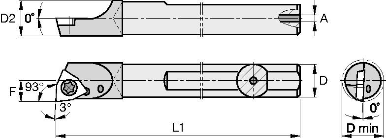

Drawings for 1930560
Material Number1930560
ISO Catalog IDE12SSWUPR04
ANSI Catalog IDE12SSWUPR04
[D] Adapter / Shank / Bore Diameter0.472 in
[DM] Minimum Bore Diameter 12.9 mm
[DM] Minimum Bore Diameter 0.508 in
[F] F Dimension 6.55 mm
[F] F Dimension 0.258 in
[L1] Tool Length 254 mm
[L1] Tool Length 10 in
[A] Coolant Hole Diameter 4.7 mm
[A] Coolant Hole Dia 0.185 in
Gage InsertWP..040204
Insert Screw ID Drive SizeT7
