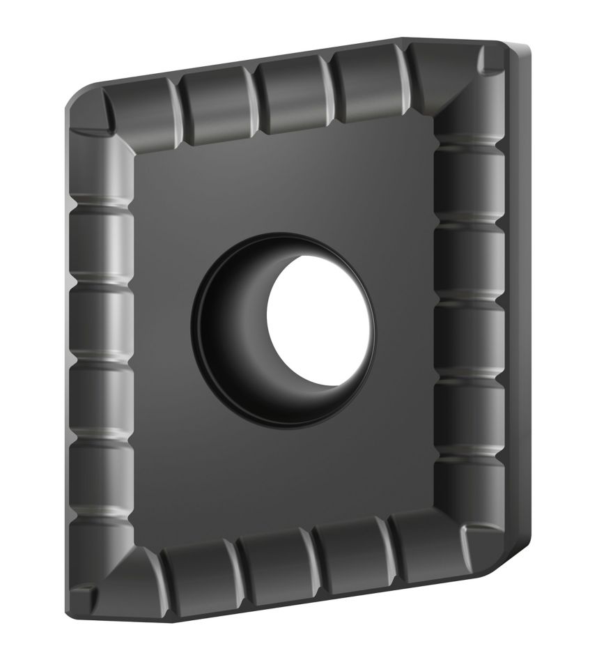

KSEM PLUS™ • Outboard Insert • DFC-MD Geometry
Modular Drilling • Carbide Insert for KSEM PLUS™ B1 Heads
Material Number7296155
ISO Catalog IDDFC05T312D32MDANSI Catalog IDDFC05T312D32MD
- P Steel
- M Stainless Steel
- K Cast Iron
- N Non-Ferrous
- S High-Temp Alloys
| Material Number | 7296155 |
| ISO Catalog ID | DFC05T312D32MD |
| ANSI Catalog ID | DFC05T312D32MD |
| Grade | KCMS40 |
| [LI] Insert Length | 12 mm |
| [LI] Insert Length | 0.4724 in |
| [W] Insert Width | 9.4 mm |
| [W] Insert Width | 0.37 in |
| [D1] Insert Hole Size | 3.4 mm |
| [D1] Insert Hole Size | 0.1339 in |
| [S] Insert Thickness | 3.75 mm |
| [S] Insert Thickness | 0.1476 in |
| [Rε] Corner Radius | 1.2 mm |
| [Rε] Corner Radius | 0.047 in |
- Steel
- Stainless Steel
- Cast Iron
- Non-Ferrous
- High-Temp Alloys
- Drilling insert for primary application in stainless steels
- DFC inserts provide lateral guidance and good hole quality
- Two cutting edges
