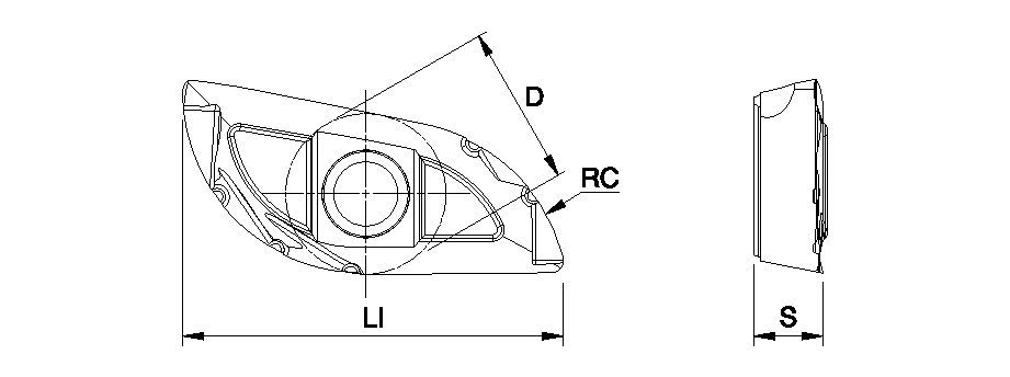

| Material Number | 5654214 |
| ISO Catalog ID | XPNT25250408RF |
| ANSI Catalog ID | XPNT080832RF |
| Grade | SP6519 |
| [D] Insert IC Size | 11 mm |
| [D] Insert IC Size | 0.4331 in |
| [LI] Insert Length | 26.075 mm |
| [LI] Insert Length | 1.0266 in |
| [S] Insert Thickness | 4.76 mm |
| [S] Insert Thickness | 0.187 in |
| [RC] Corner Radius Center | 12.5 mm |
| [RC] Corner Radius Center | 0.492 in |
| Average Chip Thickness [HM] | 0.04 mm |
| Average Chip Thickness [HM] | 0.0016 in |
