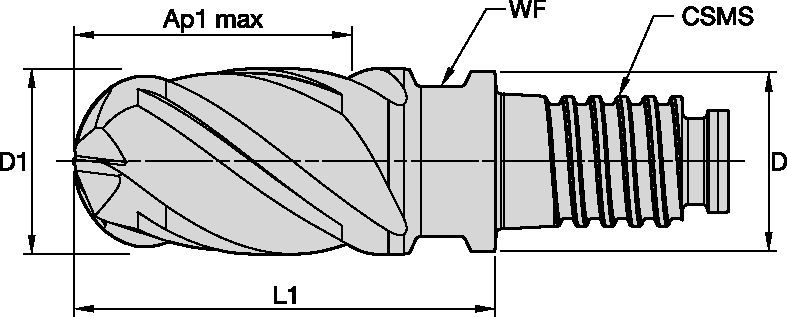

Drawings for 6070993
Material Number6070993
ISO Catalog IDUKBV0625Y4CN
ANSI Catalog IDUKBV0625Y4CN
GradeKCPM15
Adapter Style Machine SideDUO-LOCK
[D] Adapter / Shank / Bore Diameter15.375 mm
[D] Adapter / Shank / Bore Diameter0.6053 in
[AP1MAX] 1st Maximum Cutting Depth23.812 mm
[AP1MAX] 1st Maximum Cutting Depth0.9375 in
[L1] Gage Length35.7 mm
[L1] Gage Length1.4055 in
[CSMS] System Size Machine SideDL16
[WF] Width of Flat 13 mm
[WF] Width of Flat 0.5118 in
[Z] Number of Flutes4
[D1] Effective Cutting Diameter15.875 mm
[D1] Effective Cutting Diameter0.625 in
