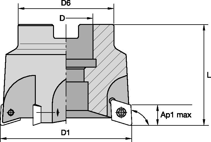

[D1] Effective Cutting Diameter52 mm
[D1] Effective Cutting Diameter2.0472 in
[D] Adapter / Shank / Bore Diameter22 mm
[D] Adapter / Shank / Bore Diameter0.8661 in
[D6] Hub Diameter 42 mm
[D6] Hub Diameter 1.6535 in
[L] Overall Length 50 mm
[L] Overall Length 1.9685 in
[AP1MAX] 1st Maximum Cutting Depth1 mm
[AP1MAX] 1st Maximum Cutting Depth0.0394 in
Number of Inserts5
Weight Kilograms1.4
Gage InsertXD_X10T3_____
