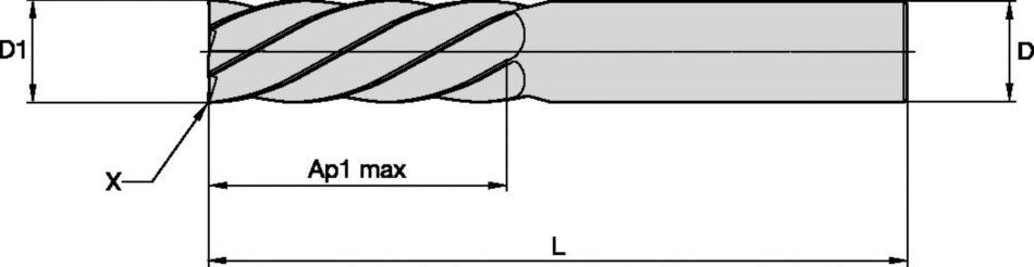

  • Tool Dimensions: Flute Configuration: 6Tool Dimensions: Flute Configuration: 6
  • Helix Angle: 25°Helix Angle: 25°

Material Number4137722
ISO Catalog IDCDDC0375J6BH
ANSI Catalog IDCDDC0375J6BH
GradeKCN05
[BCH] Corner Chamfer Width 0.254 mm
[BCH] Corner Chamfer Width 0.01 in
[Z] Number of Flutes6
[D1] Effective Cutting Diameter9.525 mm
[D1] Effective Cutting Diameter0.375 in
[D] Adapter / Shank / Bore Diameter9.525 mm
[D] Adapter / Shank / Bore Diameter0.375 in
[AP1MAX] 1st Maximum Cutting Depth38.1 mm
[AP1MAX] 1st Maximum Cutting Depth1.5 in
[L] Overall Length 101.6 mm
[L] Overall Length 4 in
