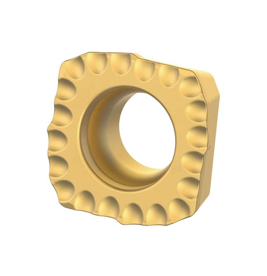

Drill Fix PRO™ • Carbide Insert • Inboard • LC Geometry
Drilling insert for Long Chipping Materials
Material Number7034325
ISO Catalog IDDFPR040203LCIANSI Catalog IDDFPR040203LCI
Drill Fix PRO™ - Carbide Insert - Inboard - LC Geometry 7034325 - Kennametal
GradeKC7140
[D1] Insert Hole Size 2.13 mm
[D1] Insert Hole Size 0.084 in
[D] Insert IC Size4.57 mm
[D] Insert IC Size0.18 in
[RR] Corner Radius0.3 mm
[RR] Corner Radius0.012 in
[W] Cutting Width 3.81 mm
[W] Cutting Width 0.15 in
[S] Insert Thickness2 mm
[S] Insert Thickness0.084 in

KC7140
KC7140
Composition: PVD TiCN/TiN coated medium-grain carbide with high toughness.
Application: Best suited for machining of steel and stainless steel. This exceptionally tough grade is perfectly suited for metastable machining conditions offering excellent tool life.
  • Four true cutting edges for lowest cost per part.
  • Inboard Insert with unique nose-profile for best positioning accuracy.
