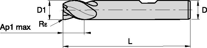

Drawings for 4046362
Material Number4046362
ISO Catalog IDF3AS1000BDK35
ANSI Catalog IDF3AS1000BDK35
GradeKCPM15
Adapter Style Machine SideWeldon
[D1] Effective Cutting Diameter10 mm
[D1] Effective Cutting Diameter0.3937 in
[D] Adapter / Shank / Bore Diameter10 mm
[D] Adapter / Shank / Bore Diameter0.3937 in
[AP1MAX] 1st Maximum Cutting Depth11 mm
[AP1MAX] 1st Maximum Cutting Depth0.433 in
[L] Overall Length 66 mm
[L] Overall Length 2.5984 in
[Re] Corner Radius 0.45 mm
[Re] Corner Radius 0.018 in
[Z] Number of Flutes3
