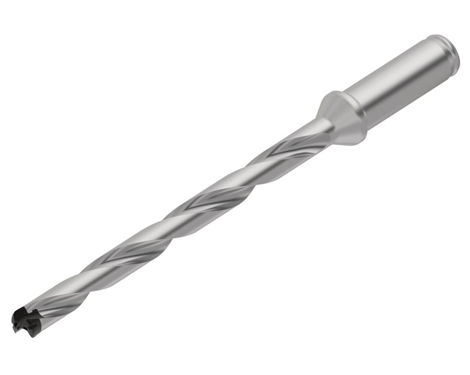

KenTIP™ FS • Drill Body • 12 x D • SF Shank • Metric
Modular Drilling • Flanged Straight Shank (SF)
Material Number6389579
ISO Catalog IDKTFS060R12SF12MANSI Catalog IDKTFS060R12SF12M
- P Steel
- M Stainless Steel
- K Cast Iron
- S High-Temp Alloys
- .caption
Drilling: Stacked Plates
Drilling - Through Coolant
Shank - Cylindrical Plain ≤h6
- Overview
- Application Data
- Downloads
- Spare Parts
| Material Number | 6389579 |
| ISO Catalog ID | KTFS060R12SF12M |
| ANSI Catalog ID | KTFS060R12SF12M |
| [D1] Drill Diameter M | 6 mm |
| [D1] Drill Diameter M | 0.2363 in |
| [D1MAX] Drill Diameter Maximum | 6.299 mm |
| [D1MAX] Drill Diameter Maximum | 0.248 in |
| [L4] Maximum Drilling Depth | 76 mm |
| [L4] Maximum Drilling Depth | 2.992 in |
| [L] Overall Length | 141 mm |
| [L] Overall Length | 5.5512 in |
| [LATTH] Insert Attach LG Holder | 92.5 mm |
| [LATTH] Insert Attach LG Holder | 3.6417 in |
| [L1] Insert Gage Length | 96 mm |
| [L1] Insert Gage Length | 3.7795 in |
| [LS] Shank Length | 45 mm |
| [LS] Shank Length | 1.7717 in |
| [D] Adapter / Shank / Bore Diameter | 12 mm |
| [D] Adapter / Shank / Bore Diameter | 0.4724 in |
| [SSC] Insert Seat Size | A |
- Steel
- Stainless Steel
- Cast Iron
- High-Temp Alloys
- .caption
- Large, ultra-high polished chip flutes guarantee hassle-free chip evacuation, enhancing tool life and performance.
- Coolant delivery to the drill point and to the rake face for guaranteed coolant delivery where it is needed.
- Every drill body comes with a KenTIP FS smart wrench. Insert exchange in the machine becomes easy and saves idle time and money.
