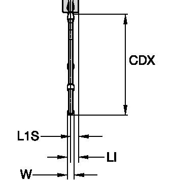

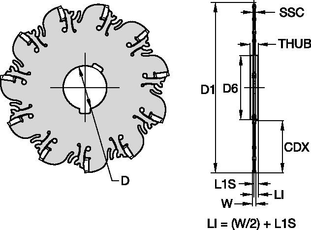

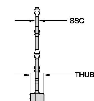

Drawings for 5614827
Material Number5614827
ISO Catalog IDKNSM100N07X21K022
ANSI Catalog IDKNSM100N07X21K022
Insert Size [SSC]21
[BM] Cutting Width Minimum2.5 mm
[BM] Cutting Width Minimum0.098 in
[BMAX] Cutting Width Maximum3.2 mm
[BMAX] Cutting Width Maximum0.126 in
[D1] Effective Cutting Diameter100 mm
[D1] Effective Cutting Diameter3.937 in
[D] Adapter / Shank / Bore Diameter22 mm
[D] Adapter / Shank / Bore Diameter0.87 in
[D6] Hub Diameter 34 mm
[D6] Hub Diameter 1.339 in
[CDX] Radial Maximum Depth of Cut32.2 mm
[CDX] Radial Maximum Depth of Cut1.268 in
[L1S] Secondary Gage Length 4.5 mm
[L1S] Secondary Gage Length 0.177 in
[W1] Blade Width 2.1 mm
[W1] Blade Width 0.083 in
[THUB] Hub Thickness 9 mm
[THUB] Hub Thickness 0.354 in
Number of Inserts7
Gage InsertXCP21_____
Weight Kilograms0.13
Max RPM800
