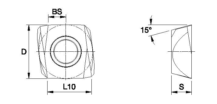

Fix-Perfect™ Cast Iron Finisher • Wiper Carbide Insert • Left Handed • MDHX-ZDFL-GD4W • Fine-Finishing
Face milling insert with four cutting edges, precision ground.
Material Number102223492
- High-precision ground insert for superior surface finish and flatness.
- Milling insert for cast iron and compacted graphite iron (CGI) machining.
- Sharp wiper cutting edge.
