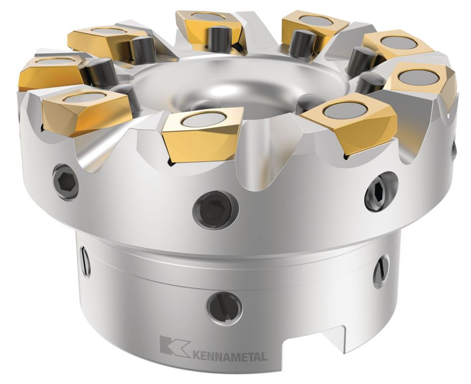

Fix-Perfect™ • Shell Mill • Fine Pitch • Metric
Face Mill • Cast Iron Machining
Material Number1886331
ISO Catalog ID200C24RP00MD10CFANSI Catalog ID200C24RP00MD10CF
Fix-Perfect™ • Cast Iron Shell Mills • Finishing
$4,043.96/each
  • Face MillingFace Milling
Drawings for 1886331
[D1] Effective Cutting Diameter188.5 mm
[D1MAX] Maximum Cutting Diameter200 mm
[D] Adapter / Shank / Bore Diameter60 mm
[D4] Bolt Circle 4101.6 mm
[D6] Hub Diameter 180 mm
[L] Overall Length 63 mm
[AP1MAX] 1st Maximum Cutting Depth1 mm
Number of Inserts24
Weight Kilograms9,85
Max RPM6350
  • Milling cutters for fine-finishing applications in cast iron and compacted graphite iron (CGI).
  • Perfect axial runout without insert adjustment.
  • High-precision pocket seat for excellent floor finish and flatness.
  • Easy handling and low-cost cutter set up.
