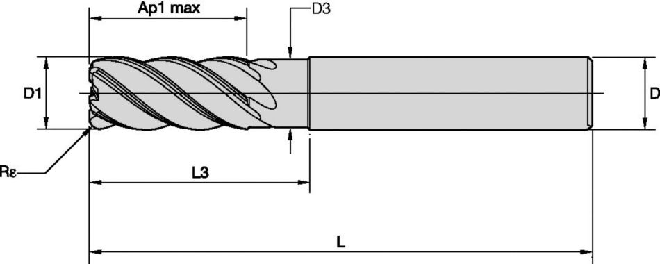

  • Ramping: 3°Ramping: 3°
  • Tool Dimensions: Flute Configuration: 5Tool Dimensions: Flute Configuration: 5
Drawings for 3524551
Material Number3524551
ISO Catalog IDUDDE1000B5ARB
ANSI Catalog IDUDDE1000B5ARB
GradeKC643M
Adapter Style Machine SideWeldon
[D1] Effective Cutting Diameter10 mm
[D1] Effective Cutting Diameter0.3937 in
[D] Adapter / Shank / Bore Diameter10 mm
[D] Adapter / Shank / Bore Diameter0.3937 in
[D3] Neck Diameter 9.4 mm
[D3] Neck Diameter 0.3701 in
[AP1MAX] 1st Maximum Cutting Depth22 mm
[AP1MAX] 1st Maximum Cutting Depth0.8661 in
[L3] Usable Length30 mm
[L3] Usable Length1.1811 in
[L] Overall Length 76 mm
[L] Overall Length 2.9921 in
[Re] Corner Radius 1 mm
[Re] Corner Radius 0.039 in
[Z] Number of Flutes5
KC643M
KC643M
Coated fine-grain grade with PVD multilayer (AlTiN). KC643M™ is a very thin and hard PVD coating particularly suited for cutting steel, cast iron, stainless steel (wet), and titanium (wet). This grade can be used for materials with hardness up to 52 HRC.
  • Versatile solid carbide end mill for steels, cast iron, and titanium.
  • HARVI™ II solid carbide end mills cover a variety of operations, including dynamic milling.
  • HARVI™ II solid carbide end mills feature unequal flute spacing for chatter-free machining at highest feed rates.
  • Slotting up to 1 x D.
