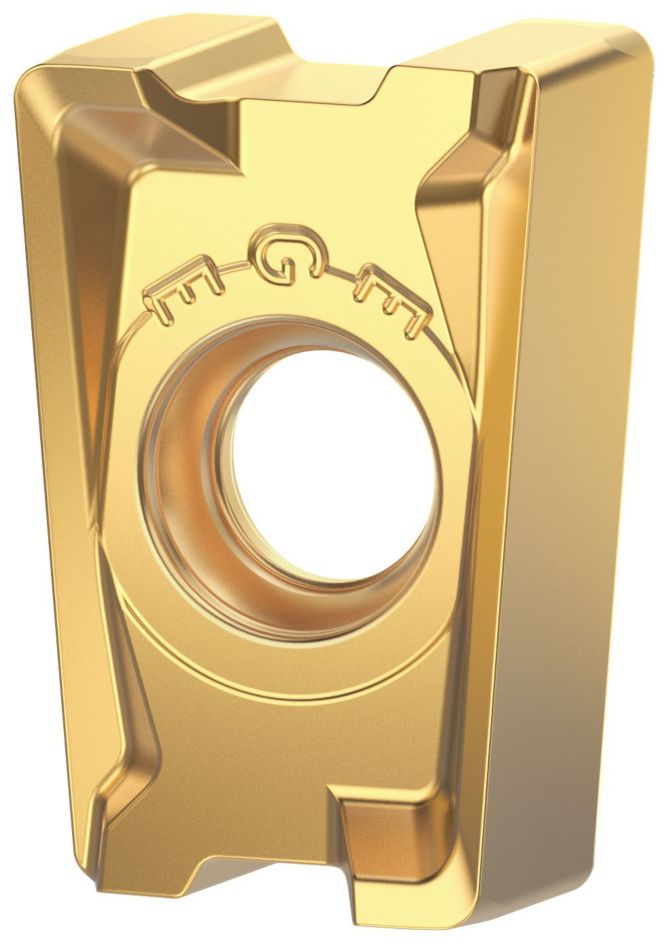

Mill 4-15™ • Carbide Insert • LNGU15-EGE • Light Machining
Shoulder milling insert with four cutting edges per insert, precision ground
Material Number6165423
ISO Catalog IDLNGU15T612ERGEANSI Catalog IDLNGU543ERGE
M415 IN LNGU-ER-GE Milling - 6165423 - Kennametal
$38.51/each
Drawings for 6165423
GradeKCSM40
[LI] Insert Length 17.01 mm
[LI] Insert Length 0.67 in
[S] Insert Thickness6.96 mm
[S] Insert Thickness0.274 in
[W] Insert Width 10 mm
[W] Insert Width 0.394 in
[BS] Corner Facet Length 1.4 mm
[BS] Corner Facet Length 0.057 in
[Rε] Corner Radius 1.2 mm
[Rε] Corner Radius 0.047 in
Average Chip Thickness [HM]0.08 mm
Average Chip Thickness [HM]0.003 in
Cutting Edges per Insert4
KCSM40
KCSM40
  • Precision ground insert for superior wall and surface finishes
