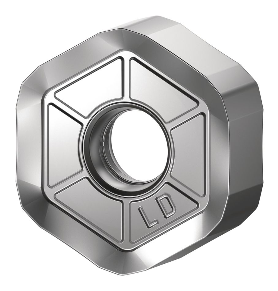

Cutting Edges per Insert12
KC522M
KC522M
Coated carbide grade with a AlTiN (PVD) coating. KC522M is engineered to provide better performance in general machining of steel, stainless steel, cast iron, and high-temperature alloys. KC522M resists breakage and offers improved wear resistance and increased strength.
  • Precision ground insert with polished rake face
  • Insert for Dodeka 15/45 cutters (metric)
  • Insert for Dodeka 75/45 cutters (inch)
