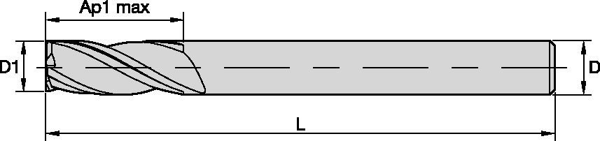

  • Tool Dimensions: Flute Configuration: 3Tool Dimensions: Flute Configuration: 3
Drawings for 6143904
Material Number6143904
ISO Catalog ID3SE0047IR011A
ANSI Catalog ID3SE0047IR011A
GradeKC633M
[Z] Number of Flutes3
[D1] Effective Cutting Diameter1.191 mm
[D1] Effective Cutting Diameter0.0469 in
[D] Adapter / Shank / Bore Diameter3.175 mm
[D] Adapter / Shank / Bore Diameter0.125 in
[AP1MAX] 1st Maximum Cutting Depth2.778 mm
[AP1MAX] 1st Maximum Cutting Depth0.1094 in
[L] Overall Length 38.1 mm
[L] Overall Length 1.5 in
