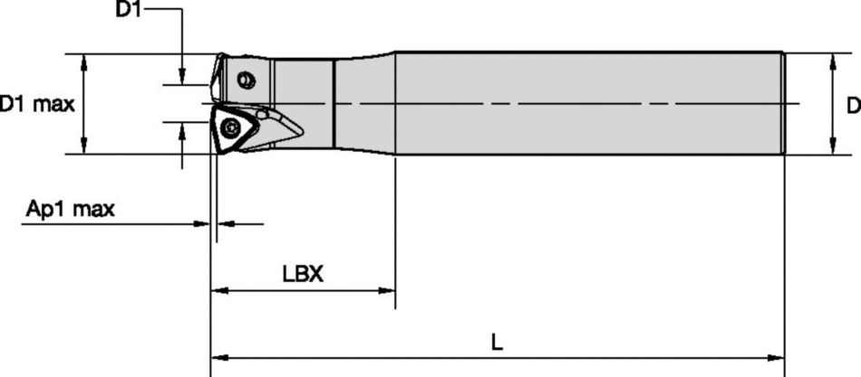

Drawings for 4109581
Material Number4109581
ISO Catalog IDKF2X100W0902C100L800
ANSI Catalog IDKF2X100W0902C100L800
[D1MAX] Maximum Cutting Diameter25.4 mm
[D1MAX] Maximum Cutting Diameter1 in
[D1] Effective Cutting Diameter8.9 mm
[D1] Effective Cutting Diameter0.35 in
[L] Overall Length 203.18 mm
[L] Overall Length 8 in
[LBX] Body Length Maximum45.34 mm
[LBX] Body Length Maximum1.78 in
[AP1MAX] 1st Maximum Cutting Depth1.5 mm
[AP1MAX] 1st Maximum Cutting Depth0.059 in
Number of Inserts2
Max RPM36600
Gage InsertWOEJ090512__
Weight Pounds1.58
