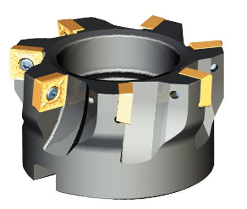

KSSM™ 10° • Shell Mill • Metric
Shoulder milling cutter for multiple materials.
Material Number1981677
ISO Catalog ID50A05RS90SP10DGANSI Catalog ID50A05RS90SP10DG

  • Face MillingFace Milling
Drawings for 1981677
[D1] Effective Cutting Diameter50 mm
[D1] Effective Cutting Diameter1.969 in
[D] Adapter / Shank / Bore Diameter22 mm
[D] Adapter / Shank / Bore Diameter0.8661 in
[D6] Hub Diameter 46.5 mm
[D6] Hub Diameter 1.831 in
[L] Overall Length 40 mm
[L] Overall Length 1.575 in
[AP1MAX] 1st Maximum Cutting Depth6.57 mm
[AP1MAX] 1st Maximum Cutting Depth0.259 in
Number of Inserts5
Weight Kilograms0.4
Max RPM26300
