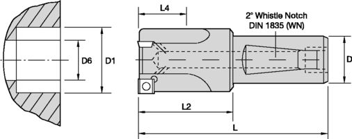

Drawings for 2204397
Material Number2204397
ISO Catalog IDCBTF210R2WD20N2M
ANSI Catalog IDCBTF210R2WD20N2M
[D1] Drill Diameter M 21.165 mm
[D1] Drill Diameter M 0.8333 in
Drill Diameter Tol. Min0.12 mm
Drill Diameter Tol. Min0.0047 in
Drill Diameter Tol. Max0.12 mm
Drill Diameter Tol. Max0.0047 in
[D] Adapter / Shank / Bore Diameter20 mm
[D] Adapter / Shank / Bore Diameter0.7874 in
Pre Machined Hole Diameter [D6]8.5 mm
Pre Machined Hole Diameter [D6]0.3346 in
[L] Overall Length 86 mm
[L] Overall Length 3.3858 in
[L2] Head Length 36 mm
[L2] Head Length 1.4173 in
[L4] Maximum Drilling Depth 16 mm
[L4] Maximum Drilling Depth 0.6299 in
Gage InsertSPHX070304R.
Number of Insert Cutting Diameter 12
