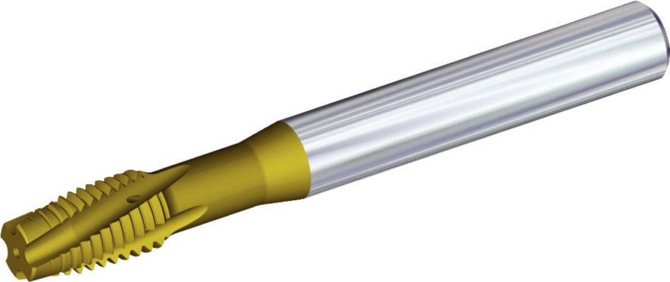

T321 • Form D Plug Chamfer • Through Coolant • Metric
Beyond™ Solid Carbide Left-Hand Spiral-Flute, Right-Hand Cut Taps • Through Holes
Material Number4153903
ISO Catalog IDT321MF140X150R6HXANSI Catalog IDT321MF140X150R6HX

  • Tapping: Through HoleTapping: Through Hole
  • Class of Fit: 6HXClass of Fit: 6HX
  • Chamfer Form D (3.5–5)Chamfer Form D (3.5–5)
  • Tapping: Through CoolantTapping: Through Coolant
  • HMHM
  • Manufacturer’s Specs: MFManufacturer’s Specs: MF
  • Tapping Helix Angle: L15°Tapping Helix Angle: L15°
GradeKC7542
[D1-TDZ] Thread Diameter SizeM14 X 1.5
[L] Overall Length 110 mm
[L] Overall Length 4.33 in
[L3] Thread Length 24 mm
[L3] Thread Length 0.94 in
[L2] Useable Length 47 mm
[L2] Useable Length 1.85 in
[D] Adapter / Shank / Bore Diameter0.4724 in
[Z] Number of Flutes4
Thread Tolerance Class ISO6HX-I

KC7542
KC7542
Coated carbide, PVD — multilayer coating with TiAlN and TiN over a high-strength carbide substrate specifically designed for tap application. Use in steel up to 32 HRC and cast iron at 4x faster speeds than HSS-E-PM taps.
  • KC7542 TiAlN + TiN for steel.
