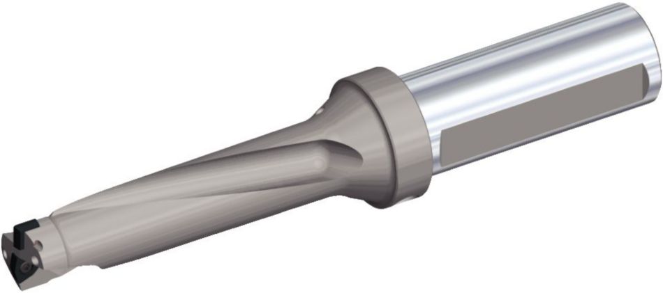

DFSP Flanged Shank • Right Hand • 4 x D
Drill Fix™ DFSP™ Bodies
Material Number5692159
ISO Catalog IDDFSP1250R4SSF150ANSI Catalog IDDFSP1250R4SSF150

| Material Number | 5692159 |
| ISO Catalog ID | DFSP1250R4SSF150 |
| ANSI Catalog ID | DFSP1250R4SSF150 |
| [D] Adapter / Shank / Bore Diameter | 38.1 mm |
| [D] Adapter / Shank / Bore Diameter | 1.5 in |
| [D1] Drill Diameter M | 31.75 mm |
| [D1] Drill Diameter M | 1.25 in |
| [D1MAX] Drill Diameter Maximum | 32.766 mm |
| [D1MAX] Drill Diameter Maximum | 1.29 in |
| [L1] Insert Gage Length | 168.27 mm |
| [L1] Insert Gage Length | 6.6248 in |
| [L4] Maximum Drilling Depth | 127 mm |
| [L4] Maximum Drilling Depth | 5 in |
| [L5] Drill Point Length | 0.96 mm |
| [L5] Drill Point Length | 0.0378 in |
| [LS] Shank Length | 95.25 mm |
| [LS] Shank Length | 3.75 in |
| [CF] Coolant Size Radial | 1/8 - 27 NPT |
| [CS] Coolant Supply Size | 1/4 -18 NPT |
| Gage Insert | SPPX09T3. |
| Gage Insert 2 | DFT05T3. |

- DFSP combines the economical squared outboard insert with the superior centering capabilities of the trigon inboard insert.
- Drill shipped with insert screws, side pipe plug, and Torx wrench.
- Order inserts for DFSP separately. See pages [REFERENCE] for inserts.
