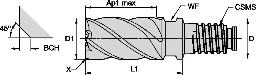

Drawings for 6072483
Material Number6072483
ISO Catalog IDUCDV1600X5CV
ANSI Catalog IDUCDV1600X5CV
GradeKCPM15
Adapter Style Machine SideDUO-LOCK
[D1] Effective Cutting Diameter16 mm
[D1] Effective Cutting Diameter0.6299 in
[D] Adapter / Shank / Bore Diameter16 mm
[D] Adapter / Shank / Bore Diameter0.6299 in
[AP1MAX] 1st Maximum Cutting Depth24 mm
[AP1MAX] 1st Maximum Cutting Depth0.9449 in
[L1] Gage Length36 mm
[L1] Gage Length1.4173 in
[CSMS] System Size Machine SideDL16
[WF] Width of Flat 13 mm
[WF] Width of Flat 0.5118 in
[BCH] Corner Chamfer Width 0.5 mm
[BCH] Corner Chamfer Width 0.0197 in
[Z] Number of Flutes5
