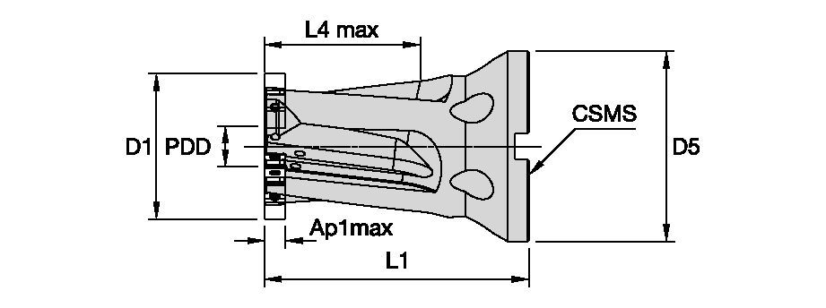

[D1] Drill Diameter M 90 mm
[D1] Drill Diameter M 3.5433 in
[PDD] Pilot Drill Cut Diameter25 mm
[PDD] Pilot Drill Cut Diameter0.9843 in
[PPL] Pilot Protrusion Length0.2 mm
[PPL] Pilot Protrusion Length0.0079 in
[L1] Insert Gage Length 160 mm
[L1] Insert Gage Length 6.2992 in
[L4] Maximum Drilling Depth 95 mm
[L4] Maximum Drilling Depth 3.7402 in
[D5] Maximum Body Diameter 117.475 mm
[D5] Maximum Body Diameter 4.625 in
[SSC] Insert Seat Size5

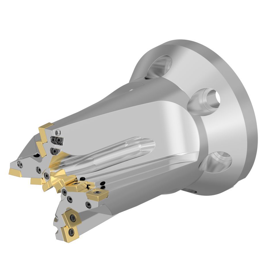

  • Advanced drill body design for flat bottom drilling and plunging
  • Two effective cutting edges in the center for maximum feed
  • Four effective cutting edges on the outer diameter for highest productivity on plunging operations
  • Interchangeable coolant nozzles in different sizes for optimized heat control
  • Four flutes for reliable chip evacuation and highest tool stiffness
  • BTF taper flange connection for maximum stability and flexibility
  • Use the pocket seat size SSC to select a suitable center insert
