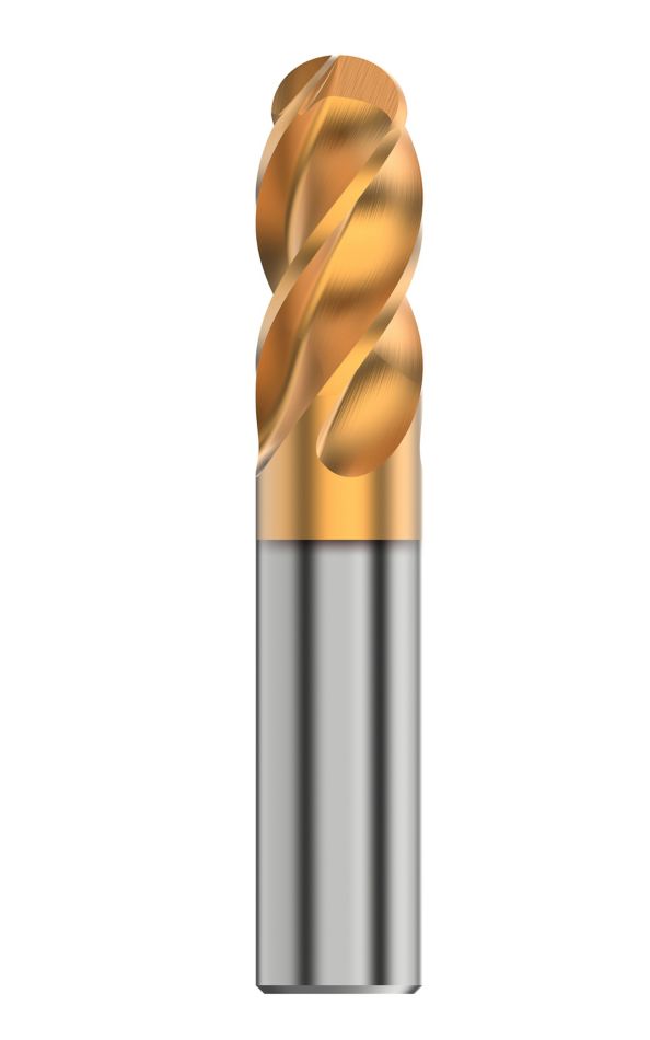

GOmill™ PRO • Ball Nose • 4 Flutes • Plain Shank • Inch
Solid Carbide End Mill for Roughing and Finishing of Multiple Materials
Material Number7301244
ISO Catalog IDGOPR4BN0875S150HAANSI Catalog IDGOPR4BN0875S150HA
- P Steel
- M Stainless Steel
- K Cast Iron
- N Non-Ferrous
- S High-Temp Alloys
- H Hardened Materials
Helical Milling
Ramping: Blank
Slotting: Ball Nose
Side Milling/Shoulder Milling: Ball Nose
3D Profiling
Corner Style: Ball Nose
Shank - Cylindrical Plain
Material Number | 7301244 |
ISO Catalog ID | GOPR4BN0875S150HA |
ANSI Catalog ID | GOPR4BN0875S150HA |
Grade | KCU20 |
Adapter Style Machine Side | Straight-Cylindrical |
[D1] Effective Cutting Diameter | 22.225 mm |
[D1] Effective Cutting Diameter | 0.875 in |
[D] Adapter / Shank / Bore Diameter | 22.225 mm |
[D] Adapter / Shank / Bore Diameter | 0.875 in |
[AP1MAX] 1st Maximum Cutting Depth | 38.1 mm |
[AP1MAX] 1st Maximum Cutting Depth | 1.5 in |
[L3] Usable Length | 46.768 mm |
[L3] Usable Length | 1.8412 in |
[L] Overall Length | 101.6 mm |
[L] Overall Length | 4 in |
[R] Profile or Ball Nose Radii | 11.125 mm |
[R] Profile or Ball Nose Radius | 0.438 in |
[Z] Number of Flutes | 4 |
- Steel
- Stainless Steel
- Cast Iron
- Non-Ferrous
- High-Temp Alloys
- Hardened Materials
Helical Milling
Ramping: Blank
Slotting: Ball Nose
3D Profiling
- An asymmetric divided flute for better vibration control and tool life and smoother cutting
- A variable helix angle for better vibration control and tool life
- A tapered core for better chip evacuation and tool strength
- Multilayer TiN/TiAlN coating for high performance at medium-high cutting on steels, stainless steels and cast iron
- Special relief design for higher edge strength, better vibration control and workpiece material flexibility
