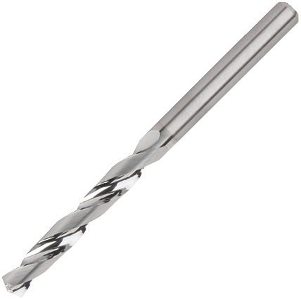

KenDrill™ HPS • 5 x D • Internal Coolant • Straight Shank • Metric
Solid Carbide Drill for Non-Ferrous Materials
Material Number5434789
ISO Catalog IDB285A08400HPSANSI Catalog IDB285A08400HPS
B285_HPS 5xD Holemaking - 5434789 - Kennametal
$226.84/each
  • DrillingDrilling
  • Tool Dimensions: 2flute/2margin/coolantTool Dimensions: 2flute/2margin/coolant
  • DIN number 6535DIN number 6535
  • DIN number 6537DIN number 6537
  • Through Coolant: MQL (Minimum Quantity Lubricant): DrillingThrough Coolant: MQL (Minimum Quantity Lubricant): Drilling
  • DIN Numbers: ER ColletDIN Numbers: ER Collet
Drawings for 5434789
GradeKN15
[D1] Drill Diameter M 8.4 mm
[D1] Drill Diameter M 0.3307 in
[L] Overall Length 103 mm
[L] Overall Length 4.0551 in
[L3] Flute Length 61 mm
[L3] Flute Length 2.4016 in
[L4] Maximum Drilling Depth 49 mm
[L4] Maximum Drilling Depth 1.9291 in
[L5] Drill Point Length1.55 mm
[L5] Drill Point Length0.061 in
[LS] Shank Length 40 mm
[LS] Shank Length 1.5748 in
[D] Adapter / Shank / Bore Diameter10 mm
[D] Adapter / Shank / Bore Diameter0.3937 in
  • DrillingDrilling
KN15
KN15
Composition: Uncoated, highly wear-resistant fine-grain carbide.
Application: Highly polished chip flute surfaces ensure superior chip evacuation and reduce tendency for built-up edges. First choice for non-ferrous materials.
  • HPS Beyond™ drills for aluminum machining with MQL.
  • Material-specific SC drill with highly polished surface that ensures superior chip evacuation and avoids built-up edge, even when MQL coolant is applied.
  • Sharp cutting edge enables higher tool life in aluminum and other non-ferrous materials.
  • HP point enables high feed rates by progressive rake angle.
  • Enlarged flute design enables fast chip evacuation and high metal removal rates.
  • Enlarged chamfer on back end according to DIN 69090-3 (round cylindrical for MQL) to ensure optimum coolant flow without leakage.
