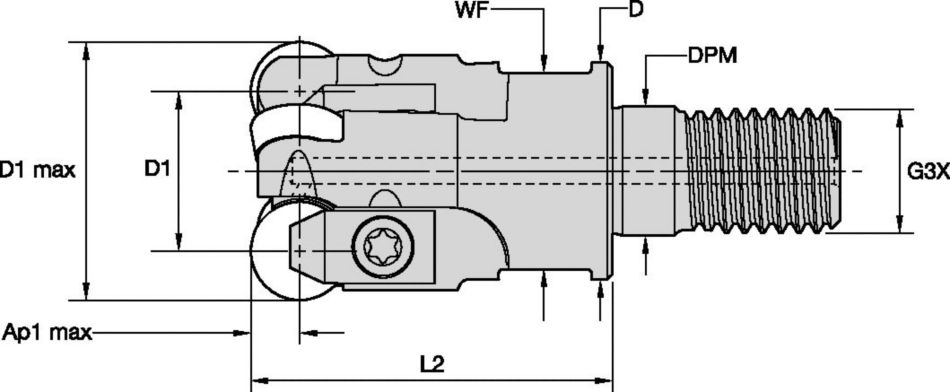

Drawings for 3101753
Material Number3101753
ISO Catalog IDKIPR032RP12MF03
ANSI Catalog IDKIPR032RP12MF03
[D1MAX] Maximum Cutting Diameter32 mm
[D1MAX] Maximum Cutting Diameter1.26 in
[D1] Effective Cutting Diameter19.46 mm
[D1] Effective Cutting Diameter0.766 in
[D] Adapter / Shank / Bore Diameter29 mm
[D] Adapter / Shank / Bore Diameter1.14 in
[DPM] Pilot Diameter Machine Side17 mm
[DPM] Pilot Diameter Machine Side0.669 in
[G3X] Connection Thread Size ExternalM16
[L2] Head Length 45 mm
[L2] Head Length 1.772 in
[WF] Width of Flat 22 mm
[WF] Width of Flat 0.864 in
[AP1MAX] 1st Maximum Cutting Depth6.33 mm
[AP1MAX] 1st Maximum Cutting Depth0.249 in
Number of Inserts3
Maximum Ramping Angle4.2
Weight Kilograms0.19
Max RPM20420
Gage InsertRP_N1204__
