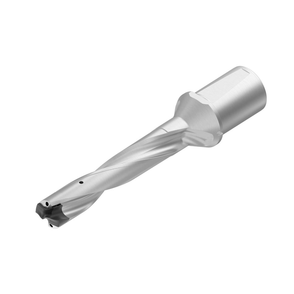

KSEM™ • Drill Body • 5 x D • WD Shank • Metric
Modular Drilling • Flanged Shank with Whistle Notch™ (WD)
Material Number1592492
ISO Catalog IDKSEM321R5WD50MANSI Catalog IDKSEM321R5WD50M
- P Steel
- M Stainless Steel
- K Cast Iron
- N Non-Ferrous
- S High-Temp Alloys
- .caption
Drilling - Through Coolant
Shank - Cylindrical Whistle Notch with Drive and Flange
- Overview
- Application Data
- Downloads
- Spare Parts
| Material Number | 1592492 |
| ISO Catalog ID | KSEM321R5WD50M |
| ANSI Catalog ID | KSEM321R5WD50M |
| [D1] Drill Diameter M | 32.01 mm |
| [D1] Drill Diameter M | 1.2602 in |
| [D1MAX] Drill Diameter Maximum | 33 mm |
| [D1MAX] Drill Diameter Maximum | 1.2992 in |
| [L4/D1] Length/Diameter Ratio | 5 |
| [L] Overall Length | 293 mm |
| [L] Overall Length | 11.5354 in |
| [L1] Insert Gage Length | 225 mm |
| [L1] Insert Gage Length | 8.8582 in |
| [L3] Flute Length | 214 mm |
| [L3] Flute Length | 8.4252 in |
| [L4] Maximum Drilling Depth | 165 mm |
| [L4] Maximum Drilling Depth | 6.4961 in |
| [L5] Drill Point Length | 4.925 mm |
| [L5] Drill Point Length | 0.1939 in |
| [LS] Shank Length | 68 mm |
| [LS] Shank Length | 2.6772 in |
| [D] Adapter / Shank / Bore Diameter | 50 mm |
| [D] Adapter / Shank / Bore Diameter | 1.9685 in |
| [SSC] Insert Seat Size | 9 |
