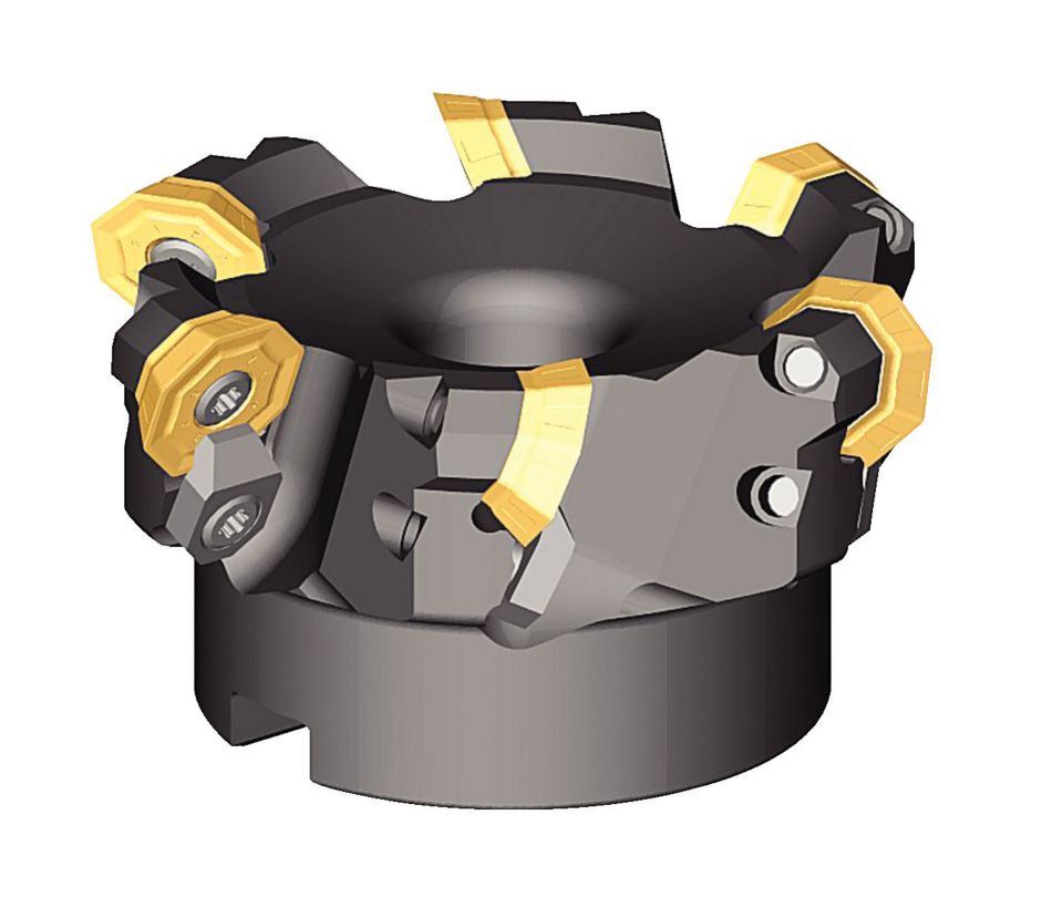

KSOM™ • Shell Mill • Metric
Face milling cutter for multiple materials.
Material Number2250670
ISO Catalog ID63A05RS45OF07AANSI Catalog ID63A05RS45OF07A
- P Steel
- M Stainless Steel
- K Cast Iron
- N Non-Ferrous
- S High-Temp Alloys
- H Hardened Materials
- .caption
Face Milling
Side Milling/Shoulder Milling: Eased Chamfer
Milling - Through Coolant
Milling - Side and Face
- Overview
- Application Data
- Downloads
- Spare Parts
| Material Number | 2250670 |
| ISO Catalog ID | 63A05RS45OF07A |
| ANSI Catalog ID | 63A05RS45OF07A |
| [D1] Effective Cutting Diameter | 63 mm |
| [D1] Effective Cutting Diameter | 2.4803 in |
| [D1MAX] Maximum Cutting Diameter | 74.3 mm |
| [D1MAX] Maximum Cutting Diameter | 2.9252 in |
| [D] Adapter / Shank / Bore Diameter | 22 mm |
| [D] Adapter / Shank / Bore Diameter | 0.8661 in |
| [D6] Hub Diameter | 50 mm |
| [D6] Hub Diameter | 1.9685 in |
| [L] Overall Length | 43 mm |
| [L] Overall Length | 1.6929 in |
| [AP1MAX] 1st Maximum Cutting Depth | 5 mm |
| [AP1MAX] 1st Maximum Cutting Depth | 0.1969 in |
| Number of Inserts | 5 |
| Maximum Ramping Angle | 6 |
| Weight Kilograms | 0.63 |
| Max RPM | 10100 |

Application Data
Plunging
| D1 mm | D1 max mm | Ap max | ramping angle (°) | ramping length mm |
| 63 | 74,2 | 11,7 | 5,5 | 121,5 |
| 80 | 91,1 | 11,7 | 4,0 | 167,3 |
| 100 | 111,0 | 11,7 | 3,0 | 223,2 |
| 125 | 135,9 | 11,7 | 2,3 | 291,3 |
| 160 | 170,8 | 11,7 | 1,7 | 394,2 |
Face Milling
| max DOC Ap | mm | chipload (fz) |
| Ap1 max | 5,0 | 1 x fz |
| Ap2 max | 11,7 | 0,6 x fz |
Ramping
| max plunging depth | mm |
| Ap1 max | 4,2 |
Helical Interpolation
| D1 mm | D1 max mm | hole diameter | Ap/rev mm | |
| min mm | max mm | |||
| 63 | 74,2 | 122,7 | 145,0 | 6,3 |
| 80 | 91,1 | 156,6 | 178,0 | 6,3 |
| 100 | 111,0 | 196,5 | 218,7 | 6,3 |
| 125 | 135,9 | 246,4 | 268,7 | 6,3 |
| 160 | 170,8 | 316,3 | 338,6 | 6,3 |
Insert Selection Guide
| (Light geometry) | – | (Strong geometry) | ||||
| wear | toughness | |||||
| P1–P2 | .E..LB | KCPK30 | .E..GB | KCPM40 | .S..HB | KCPM40 |
| P3–P4 | .E..LB | KCPK30 | .E..GB | KCPK30 | .S..HB | KCPK30 |
| P5–P6 | .E..LB | KC725M | .E..GB | KC725M | .S..HB | KC725M |
| M1–M2 | .E..LB | KC725M | .E..GB | KC725M | .S..HB | KC725M |
| M3 | .E..LB | KCSM40 | .E..GB | KCSM40 | .S..HB | KCSM40 |
| K1–K2 | .E..LB | KCK15 | .E..GB | KC520M | .S..HB | KCK15 |
| K3 | .E..LB | KC520M | .E..GB | KC520M | .S..HB | KC520M |
| N1–N2 | .F..LNJ | KC410M | .F..LNJ | KC410M | .F..LNJ | KC410M |
| N3 | .F..LNJ | KC410M | .F..LNJ | KC410M | .F..LNJ | KC410M |
| S1–S2 | .E..LB | KC725M | .E..GB | KC725M | .S..HB | KC725M |
| S3 | .E..LB | KCSM40 | .E..GB | KCSM40 | .S..HB | KCSM40 |
| S4 | .E..LB | KCSM40 | .E..GB | KCSM40 | .S..HB | KCSM40 |
