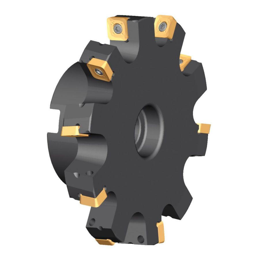

KSSM™ Fixed-Width Slotting Cutters • 10 mm IC Inserts • KSSS™ Shell Mount • Neutral • Full Slot • Inch
KSSS™ • Shell Mount
Material Number2629783
ISO Catalog IDKSSS800BSP10N625ANSI Catalog IDKSSS800BSP10N625
KSSM™ Fixed-Width Slotting Cutters - 10 mm IC Inserts - KSSS™ Shell Mount - Neutral - Full Slot - Inch 2629783 - Kennametal

  • Slotting: Side with AE/AP dimensionsSlotting: Side with AE/AP dimensions
Drawings for 2629783
[D1] Effective Cutting Diameter203.2 mm
[D1] Effective Cutting Diameter8 in
[D] Adapter / Shank / Bore Diameter38.1 mm
[D] Adapter / Shank / Bore Diameter1.5 in
[D6] Hub Diameter 96.774 mm
[D6] Hub Diameter 3.81 in
[BM] Cutting Width Minimum15.596 mm
[BM] Cutting Width Minimum0.614 in
[CDX] Radial Maximum Depth of Cut51.562 mm
[CDX] Radial Maximum Depth of Cut2.03 in
[L1] Gage Length50.8 mm
[L1] Gage Length2 in
Number of Inserts14
Number of Effective Cutting Edges on Face7
Max RPM12100
Weight Pounds8.8
  • Neutral slot width (B min) is .614" + .010".
  • Neutral cutting.
  • Large selection of insert geometries and grades to cut most workpiece materials.
  • Four insert cutting edges.
  • Wide selection of insert radii.
  • Faceted inserts for superior surface finishes.
