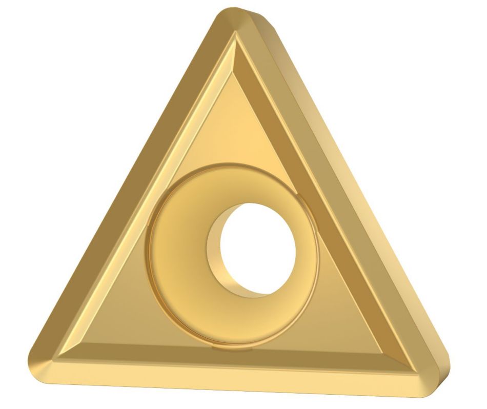

Drawings for 3769462
Material Number3769462
ISO Catalog IDTPMT16T304FP
ANSI Catalog IDTPMT3251FP
GradeKCU25
[D] Insert IC Size9.525 mm
[D] Insert IC Size0.375 in
[L10] Insert Cutting Edge Length16.5 mm
[L10] Insert Cutting Edge Length0.6496 in
[S] Insert Thickness3.97 mm
[S] Insert Thickness0.1563 in
[Rε] Corner Radius 0.4 mm
[Rε] Corner Radius 0.016 in
[D1] Insert Hole Size 4.4 mm
[D1] Insert Hole Size 0.1732 in
KCU25
KCU25
Composition: An advanced PVD grade with hard AlTiN coating and fine-grain unalloyed substrate. The new and improved coating improves edge stability with wide range speed and feed capabilities.
Application: The KCU25™ grade is ideal for general machining of most steels, stainless steels, high-temp alloys, titanium, irons, and non-ferrous materials in a wide range of speeds and feeds with improved edge toughness for interrupted cuts and high feed rates.
