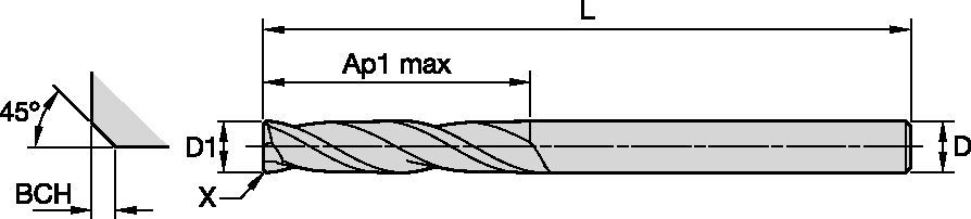

GOmill™ GP • Chamfered • 2 Flutes • Plain Shank • Metric
General Purpose Solid Carbide End Mill
Material Number101242164
- Solid carbide end mill with excellent cost-benefit ratio.
- Eccentric relief increases cutting edge stability for long tool life and high surface quality.
- Eccentric relief eases regrinding and reduces reconditioning cost.
- Center cutting for plunging and ramping operations.
Fresatura in rampa: Grezzo
Scanalatura: Testa piana
Contornatura/fresatura a spallamento: Testa piana
Dimensioni utensile: Configurazione del vano: 2
Angolo elica: 30°
Tipo angolo Angolo smussato
