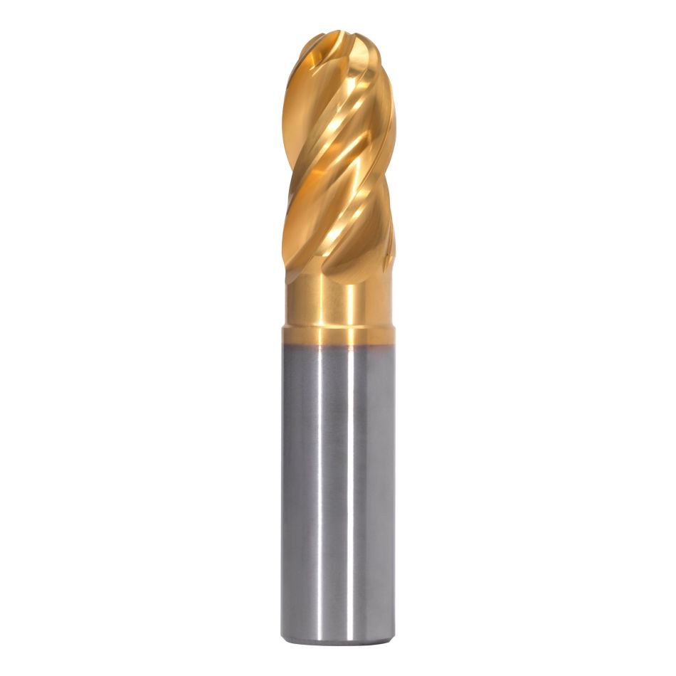

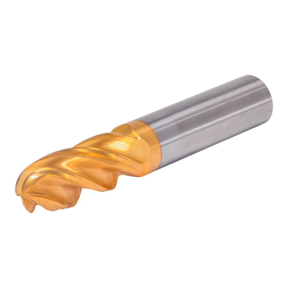

GOmill™ PRO • Ball Nose • 4 Flutes • Necked • Plain Shank • Metric
Solid Carbide End Mill for Roughing and Finishing of Multiple Materials
Material Number109353097
- Unequal flute spacing for better vibration control and tool life.
- Multilayer TiN/TiALN coating for high performance at medium-high cutting on steels, stainless steels and cast iron.
- Ideal for shops working in the general engineering, transportation, energy and medical industries.
- Designed for side and shoulder milling, helical milling, pocketing, slotting and ramping.
Fresatura a riccio
Fresatura in rampa: Grezzo
Scanalatura: Testa sferica
Contornatura/fresatura a spallamento: Testa sferica
Profilatura 3D
Corner Style: Ball Nose
Codolo — Cilindrico liscio
